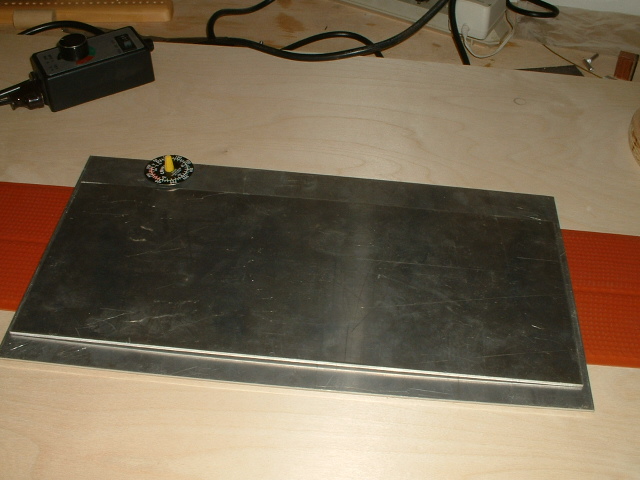

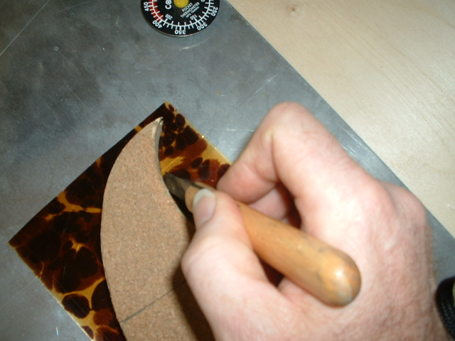

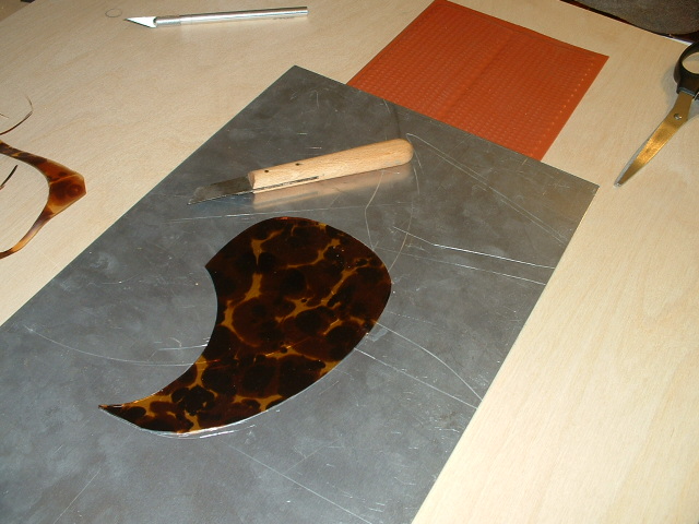

Regarding a recent discussion regarding Tor-Tis, I thought I'd offer a simple way I've found of working with it. It does involve some heat, but no water (messy). A few pictures will convey the idea best, I think:
Heated up to ~ 135 degrees F, it cuts like butter; much hotter and it wants to stretch. Use a sharp knife and one pass is all that's needed. Take the aluminum plate off the heat blanket and in a minute or so it's hard and ready to bevel and polish. Works like a charm for me.

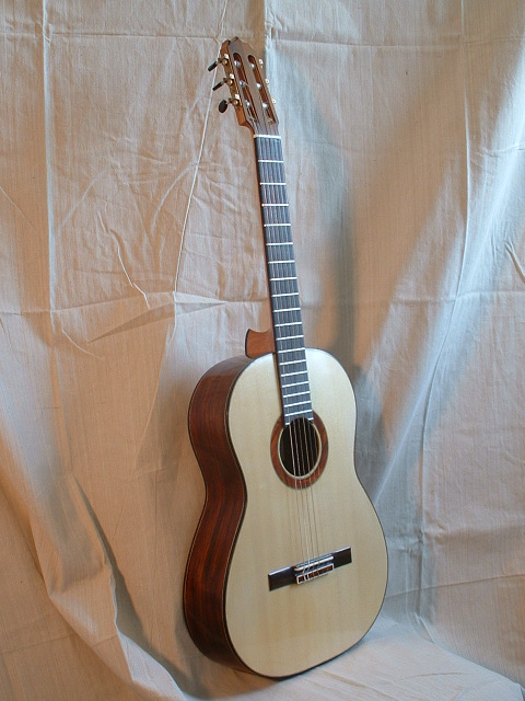

Here's a pics of one of two models of classical I build:
My classicals and flamencos are French polished; I use Target USL on most of my steel-strings.

James...welcome to the OLF. On your heating plate is that some sort of surface thermometer?

This is a great idea! Looks like that's a metal plate on top of a side bending blanket.
I was thinking about trying some plate glass on a food warming tray.

Hi Brad. Yes, it's a simple bi-metal surface thermometer. I keep several of these around. Very handy for checking temp of bending forms, heat blankets, etc. I calibrate them using my DMM and a thermocouple. They are reasonably accurate and are cheap ... $7.95 at my local hobby shop. I think Stew-Mac sells them too -- different brand, cost a bit more.
